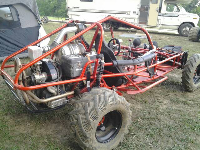

PostPosted: Tue Sep 30, 2014 9:17 am
Dont think there making these center outlets no more, but this is the style you want for a single carb.works awesome

Yup that's exactly what I want, I cringe just thinking about water getting in my engine! :cry: nice buggy!

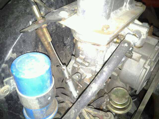

6 rows down on the left, part #17-2526-0 , and if you have that shitty linkage that comes with a weber carb, you should look into the cb performance cable setup , i have it and it is awesome as well, but you have to fab up a bar to hook it to with the breather box. i can give you links and show you a pic of what im talkin about.
PostPosted: Tue Sep 30, 2014 9:07 pm
ok hear is what im talkin about...http://www.cbperformance.com/SearchResu ... =60&page=1 the 3122 linkage kit is what i bought and used with a garbage can cover, but with the breather box the breather base plate gets tossed out so you have to make a braket for the cable to hook yo, not that big of a deal. ill get some pics for you tomorrow

Thank you diamonddave you helped out a lot I am definitely getting a new linkage. My throttle response is rather terrible because of slack in the line and, Saturday I'm going to go up to drews and see what they have and if they don't have what I'm looking for I will order of the website. Thanks everybody for the very thorough details I'm new to buggys and vw engines so I'm trying to soak up as much as possible. Joe

No problem.hereis the cable bracket you have to fab up
