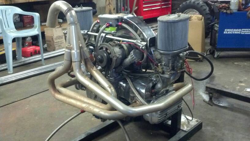

Thought a few of you guys might like looking at some pics i took on this rebuild...

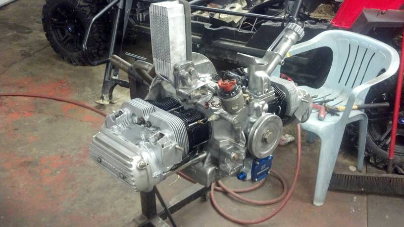

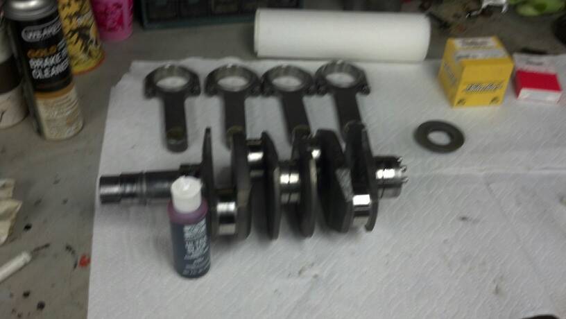

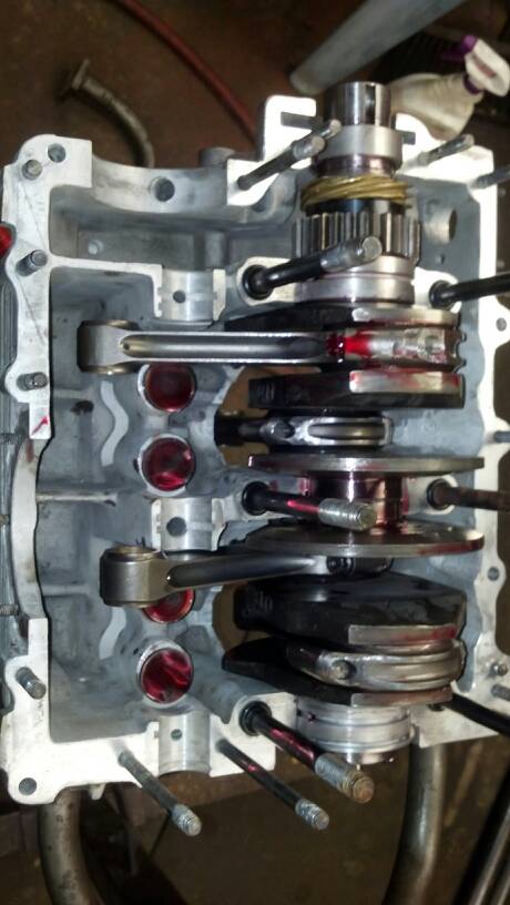

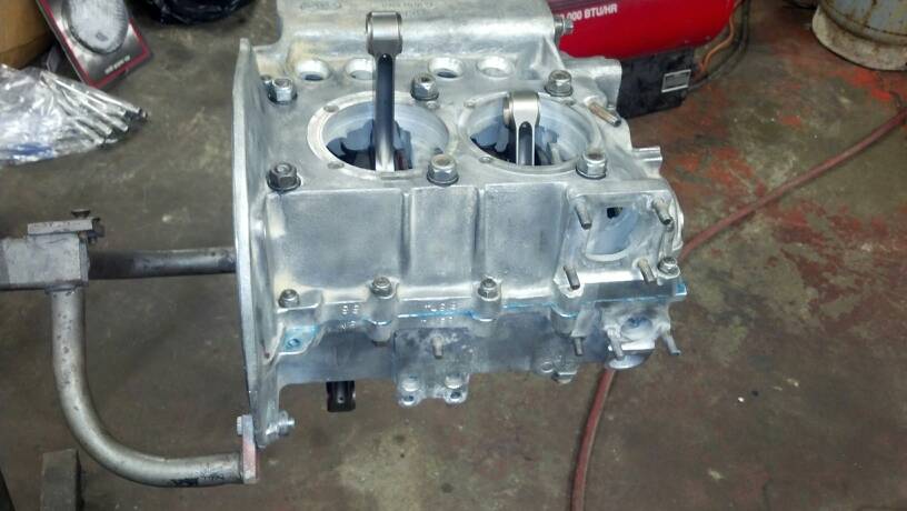

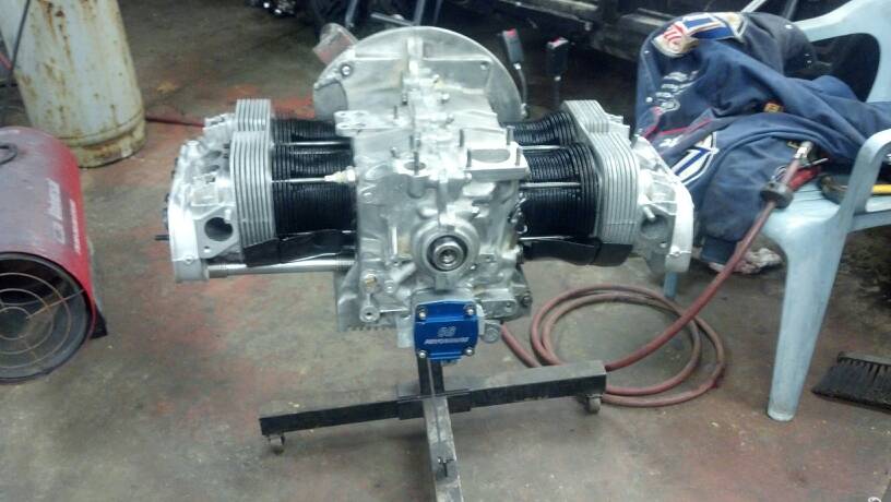

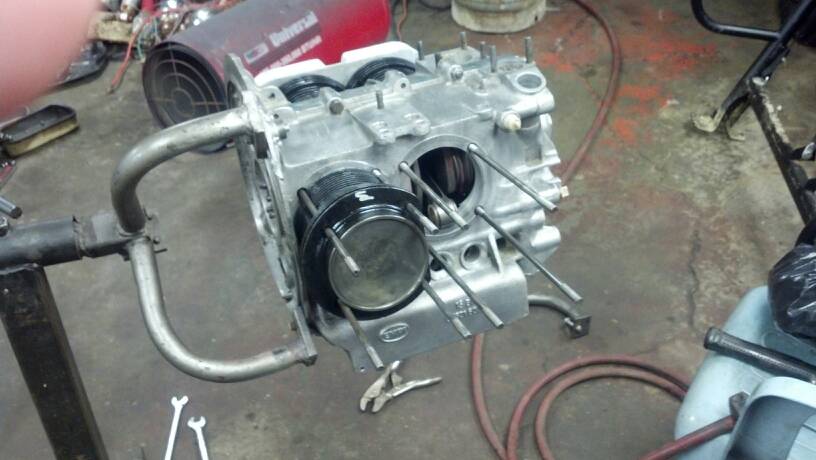

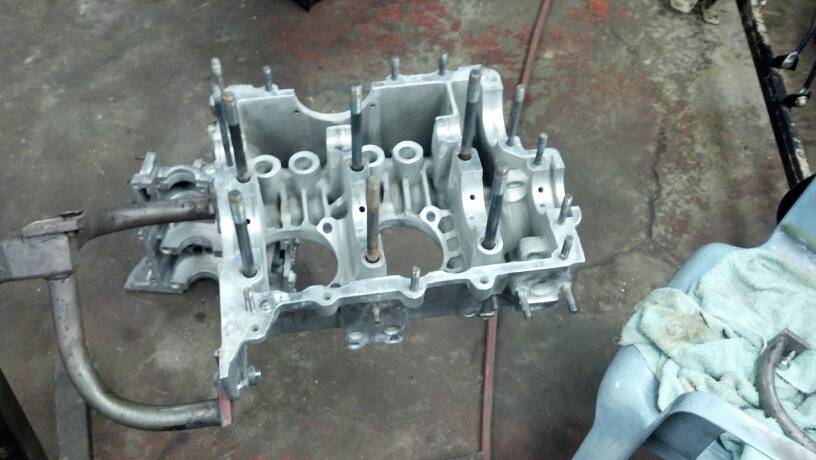

This build started out with and aluminum block and a set of 5.5 cb. Rods . 84 mm crank and yeah it is lightened

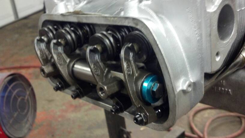

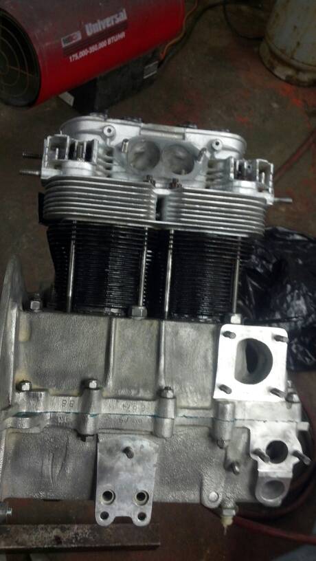

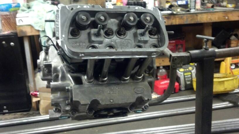

Used a set of CB 044 heads stainless steel pushrod tubes new rings specially ground cam a set of Scott rockers chromoly push rods

All new valve springs guides was all replaced new valve job

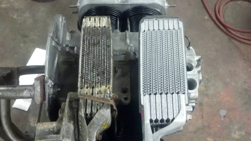

I used a type 4 oil cooler they work so much better then the type 1 a little extra work cutting tens and fittings . I also used CB oil pump dry sump . Diamond Dave was helping me cut the tens for the wider oil cooler

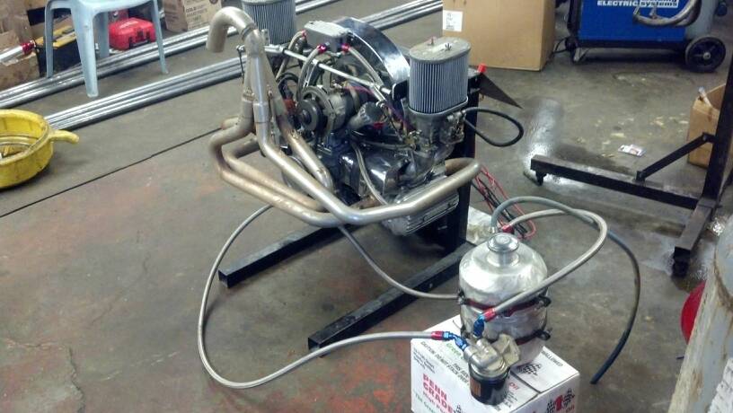

And this is cam break in time. Motor sounds real good I got a video if I can figure out how to put it on here

I would like to see more pics of the oil cooler housing conversion. Thanks Dave T

Darrel....Get a dam good filter! In that 1 st pic there is residual locktite. I had to break down a motor once because of some other reason. But while I had the rod bearrings off I noticed they had lots of scoring and if you look real close you'd see a tiny tiny red dots here and there. I ran a Fram tough guard, but, I'd change oil and get a filter from Nascar lol. I got a recently rebuilt w/c motor once and it locked up because someone had too much rtv around the valve cover and oil pan and it all clogged the oil pick up screen. Pull your pick-up screen off and investigate! Spray it out with carb cleaner and you will see some red flakes. Catch them while you still can. These tiny red dots get past the oil filter probably thru the built in oil filter relief valve maybe.
PostPosted: Sun Feb 02, 2014 1:57 pm
I don't know what filter you're looking at ? I always use a Wix Mobil 1 or Napa filter they are all made at the same company. I think you're looking at a old filter that I pulled off of a rail buggy a while back but that's not the filter I run the motor on. And I run Brad Penn oil also and I've had my fair share of oil filter problems 2.
PostPosted: Sun Feb 02, 2014 2:34 pm
I see what you're talking about now Passat n that picture. that is not Loctite it is assembly lube that you're looking at if you notice I put it all over the lifter tops also.
