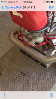

I made some small aluminum brackets thats held down by the mounting stud
PostPosted: Thu Nov 14, 2013 11:51 am
I just ran a spring from the hex bar where the throttle cable hooks up to my exhaust pipe where the spring go on the collector good luck

I just hooked the spring to the bottom filter mount.

I did something like Rick did . Works good
