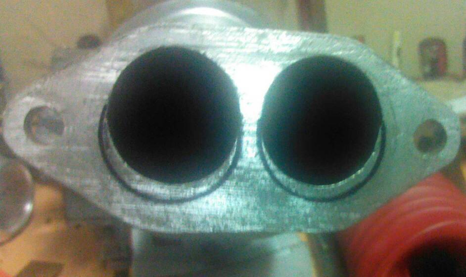

Was going to start gasket matching my intake manifolds today and found another reason to not buy empi shit. Put my gasket up to the manifold to draw the line and found a serious casting shift problem. The intake ports are off center about a quarter inch. Anyone around Columbus have a tig welder to fill these in a little bit so I can match them to the heads?

Why not just open the heads to match instead of trying to weld the port in the intakes up?
PostPosted: Thu Nov 07, 2013 11:07 pm
I don't plan on keeping these carbs forever I eventually plan on moving up to Weber 40's. I don't want to match $800 dollars worth of heads to these kadrons.
PostPosted: Thu Nov 07, 2013 11:20 pm
Posts: 349
Location: Germantown Ohio
In that case just match them as good as possible and run it.

I would re-locate the two bolt holes as far as I could first. In fact I would build up the outside of the flange to move the bolt holes where they need to be before I would weld up the runner.

Just hogg'em out and let it go

Hogging them out would require hogging and my heads too. I'm a little Leary on masacuring a set of $800 heads. I swallowed my pride and realized this is above my talent and equipment level I dropped them off at a welding shop today. Thanks to the guys that offered there help but this welding shop charged me less than what it would take to ship/drive these things back and forth.

Problem solved.
