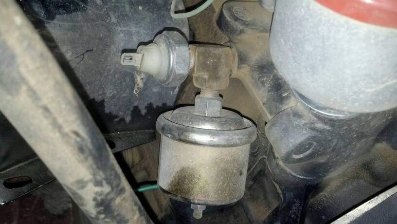

 Post subject: Re: Need ideas
PostPosted: Wed Oct 09, 2013 9:54 am
Like this.

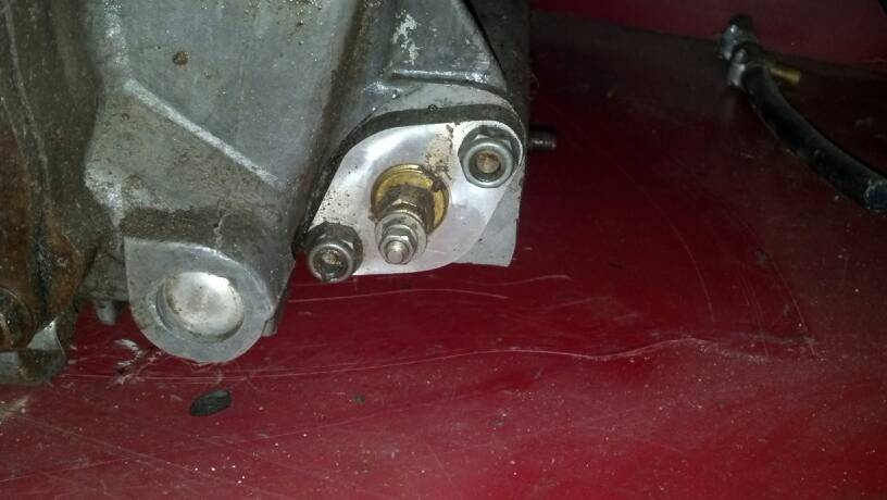

PostPosted: Wed Oct 09, 2013 3:48 pm
Ripinitup wrote:
That would be for the oil pressure or temp?
I have a T at the block. Make sure you get the correct metric pipe thread. Sorry I forget the size. Then run pressure and light there. Then you could put the temp on the oil filter. Or if you have a type 3 case you can put the temp where the type 3 dipstick goes. They make an adaptor for it. Think it's like $12.00.
