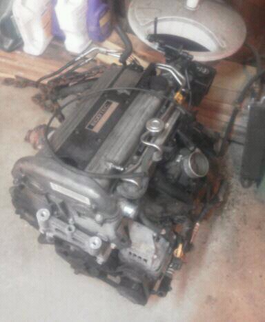

PostPosted: Fri Sep 13, 2013 8:44 pm
The dark side calls to many of us :evil:

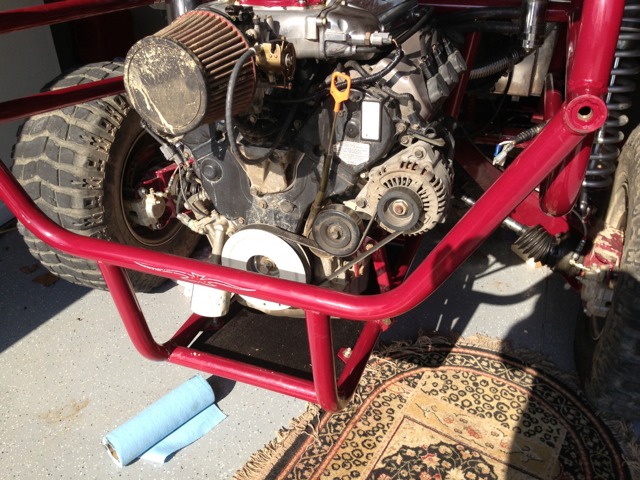

Yes the torque and horse power on the dark side is multiplied
