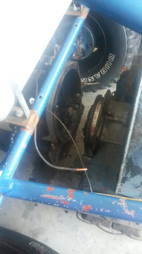

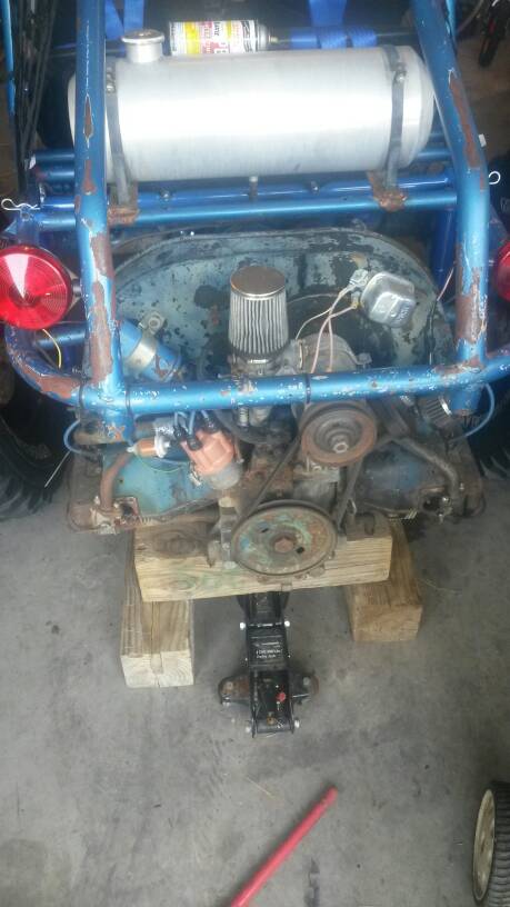

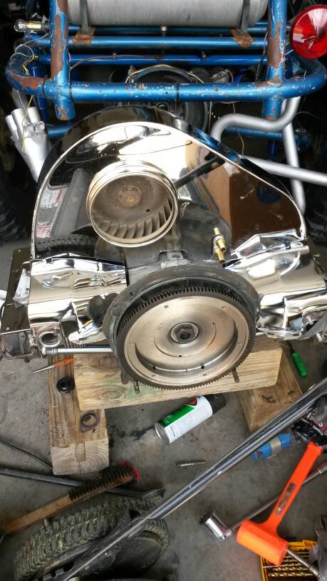

Some before and after pics

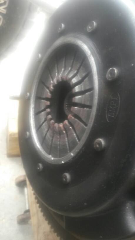

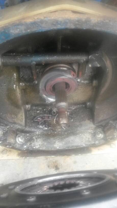

Ok so it looks like my clutch setup is the problem. The collar on the pp has welded its self to whats left of the throw out bearing. So I guess I didnt have the right bearing.?.
 Post subject: Re: clutch kills engine
PostPosted: Fri Aug 09, 2013 1:37 pm
Joined: Thu Jul 25, 2013 2:48 pm
Posts: 18
First I would like to thank everyone for their help on this. And second I want to remind everyone of my first post where I said im new to this.....aaand last I guess I should tell you that I had the $&#@ing throwout bearing on backwards.
