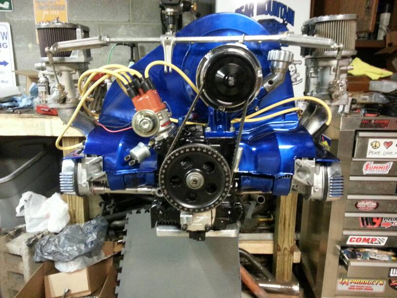

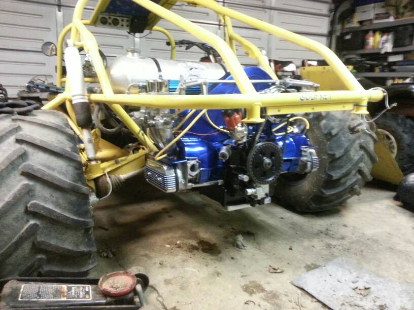

PostPosted: Mon Feb 03, 2014 4:49 pm
Joined: Sun Jan 16, 2011 5:42 pm
Posts: 60
Location: Shinnston WV
Getting her in there :)
