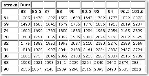

Thanks guys. How much diffrence would I feel in each motor. And I have a 3 and 6 rib. What would be a better gear for the 31 tls boggers. Wnat are my opctions as far as what I can build with the least machine work.
 Post subject: Re: a drivers opinon?
PostPosted: Sun Sep 22, 2013 3:18 pm
Here look at this for options to go with on the crank with your 92 bore

Thank you all for the info? How big can I go with stroke before I have to do machine work? With that motor with duals will there be a big diff in power from my 1835. I have the dual carbs but everything else I have to reuse( case heads pistons?).I am going to do a re build because it is smoking bad and it has been a few years but I want to do it while getting the best I can for the buck? Any thing helps. What do I need to do with what I have for the least money????

I believe he is askin ab clearance or the crank. Just get a 82 crank and all you need is a grinder really. Got to grind the cam or get a pre clearance cam. And grind on the rods a little if they are stock. I haven't look but somebody should post how to clearance a case video like the groovin tires vid

I have to agree with both red boron and nri. Go water cooled, always a great choice! Heck, I even went water cooled. But on the serious side, nri makes a good point. Go with the 82mm crank. Quite a bit less clearancing on the case vs the 84. I have built all of the engines that our group runs and the last 5 were 2332's. On my old buggy I am still running a 2276 that has some big heads, dual 44's, and a decent exhaust. None of the others can touch me. Displacement isn't everything.

Ok so I guess it will be a 2110. How big of a diffrence will there be in power and low end torque. What internals do I want. Any info helps. Thanks
