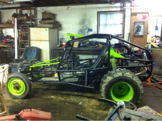

Nope I just got steel wheels I had 31x15.50 denmans they felt heavy
