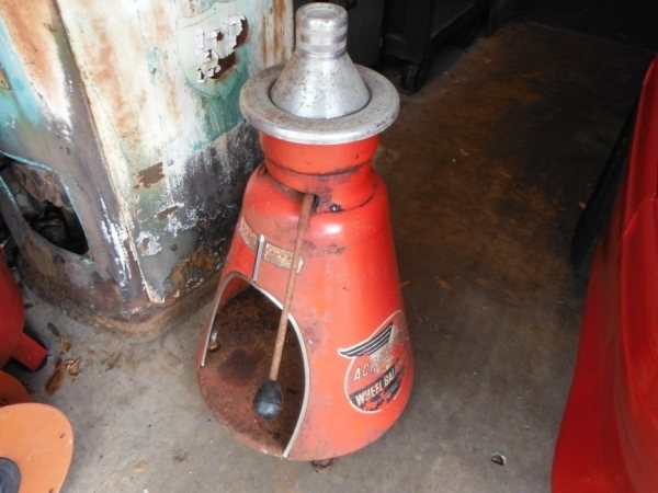

If you have any old school shops around they may have an old school balancer. If they have all the pieces should be able to do it. That's how they did it when wide 5's where new lol. I have found bike shops usually have them. Or you can find them on CL cheap some times.

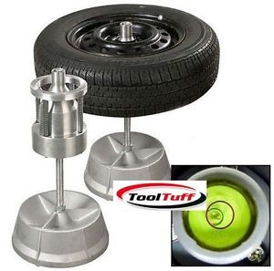

There's a piece on The Samba to use that bolts to wide 5 rim to spin balance them. It's not bad high, if you would need it often. about $50 or so. tried to find it but can't. thought I had it saved.

I don't think or hope that I would be balancing very often so I will pass on the e-bay stuff.
I think I will try the Air-soft way. It won't cost very much.
