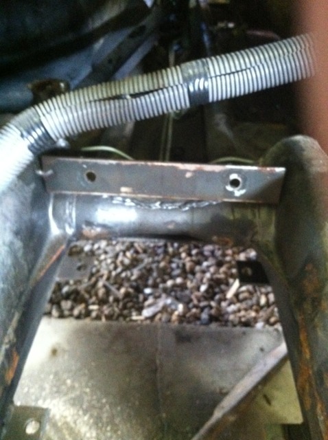

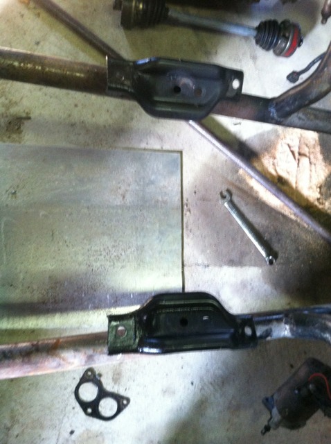

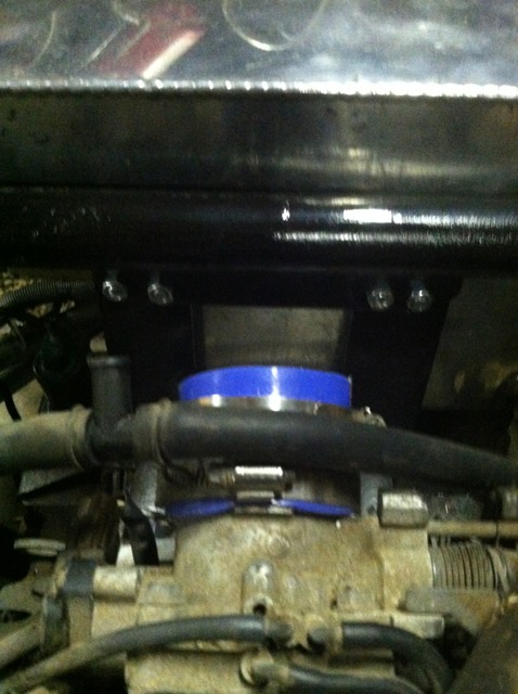

Need your thoughts on this . If I remove the two tabs that connect to the top of the transmission it would be much easier to install motor and trans do you guys feel the engine mounts and front trans mount would be enough to hold it in place without having issues ?

PostPosted: Sat Oct 05, 2013 9:48 am
What engine are you gonna run?
PostPosted: Sat Oct 05, 2013 9:51 am
Subaru :twisted:
PostPosted: Sat Oct 05, 2013 10:14 am
I shoulda know by the gasket Layin there lol. Is there a way to make them removable so they can be taken out and reinstalled??
PostPosted: Sat Oct 05, 2013 8:27 pm
Posts: 1262
Location: connellsville,pa
I run all 4 bolts in front mount . and both top and bottom in rear. but with a subi you should be fine lol :evil: :twisted: :mrgreen:
PostPosted: Sat Oct 05, 2013 8:51 pm
If it was easy everybody would have one,lol. :D I'd run it with all the mounts myself. Chad :mrgreen:
PostPosted: Sun Oct 06, 2013 8:29 am
Use the top mounts and add the ones on the bottom of the engine.
PostPosted: Mon Oct 07, 2013 7:18 pm
Bunji cords and duck tape or some fab and grade 5 bolts
PostPosted: Mon Oct 07, 2013 9:34 pm

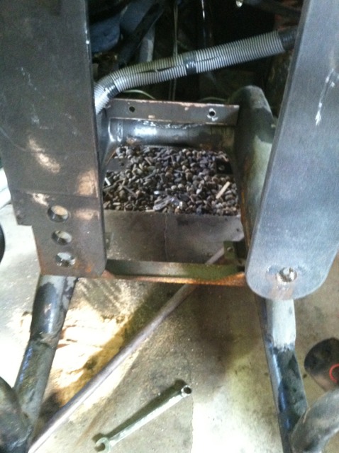

thanks guys . I ended up just welding a plate behind the tabs and drilling two bolt holes per tab . I was making it harder then it was ! Lol
PostPosted: Mon Oct 07, 2013 11:09 pm
Made it removeable I see lol
