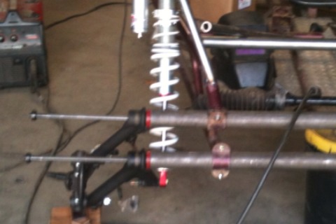

Here is a pic with the Thur rods pulled half way out of beam, if that helps

Posts: 162
Yeah that picture is very helpful do they seem to hold up to a lot of abuse and what size should I run 1/2 or 5/8
