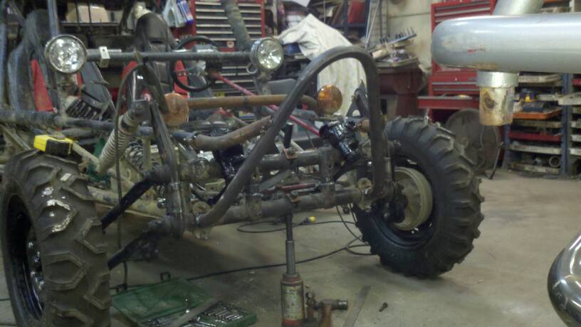

Not knocking on the ball joint front end but why mess with. Get rid of ball joint part and put kingpin. If you look close we cut a king pin and made it fit ball joint.

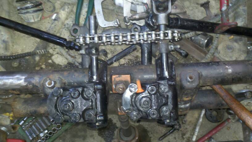

Is it just me or is there 2 steering boxes on the beam ?
PostPosted: Sun Sep 08, 2013 9:23 pm
Some guys keep a spare. Some random guy Saved my day once with his spare!
PostPosted: Sun Sep 08, 2013 9:26 pm
If you want ground clearance u can make drop spindles the ride won't be near as nice as longer arms. You can't get the travel out of a balljoint as you can kingpin.
PostPosted: Sun Sep 08, 2013 9:37 pm
Yes to boxes with motorcycle sprockets and chained together broke a box so Paul (lpb) and I built this worked pretty good.
PostPosted: Sun Sep 08, 2013 9:42 pm
2 working together is stronger than 1:razz:
PostPosted: Sun Sep 08, 2013 9:51 pm
Ya I walked in and said what in tarnation you 2 doin. And it worked great still on bens old buggy no broke boxes again lol

I cut mine and added 2-1/2 inches to them. Had to notch the ball joint a little but it still isn't enough. I've seen different balls that travel farther just haven't looked into it more. If you go to much then they bind up and don't allow the travel your trying to get anyways with the stock ball. Another thing with the extra length it weakened the front torsion springs and I had to run a little more in the shock. But with the length of the new arms plus 3" raised spindles I got killer ground clearance with just stock 3 rib tractor tires and it rides great. Chad :mrgreen:
