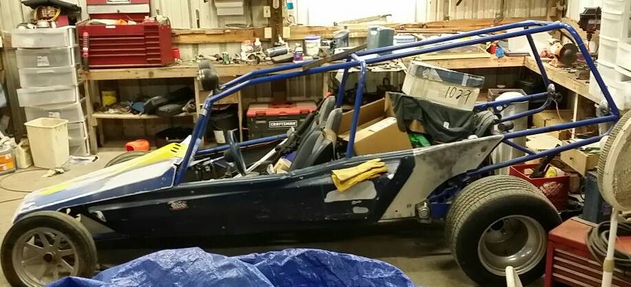

I picked up this four seat buggy last year and ran the dying engine to its grave. Now I've decided to do the full rebuild. It already came with alot of good parts but most I'm gonna sell.
The goods are suspension seats,15x14 aluminum wheels, Neil peddle set. Jamar upright dual handle steer brake. Aluminum king pin beam. The bads are a bad motor, swing axle trans., and spindle front rims.
What I've decided so far is six wider 10in. shock tower beam and I've already accomplished that. Also 3x3 rear arms, air bags,a mid shift trans, and a 2.4 eco tech. Another hope behind the back seats, x bracing in the hoops that are behind the front and rear seats, and in the roof. More bracing in the front, Saturn p/s. Front brakes. 2000 something mustang rear calipers w/ ebrake. And a air system for the air bags. And as soon as I get my laptop back I will be posting alot of picks of what I've done so far and as it goes. And I'm sure I will be messing up and if you see let me know, I'm very open to opinions from y'all cause I've been reading post non stop since October.

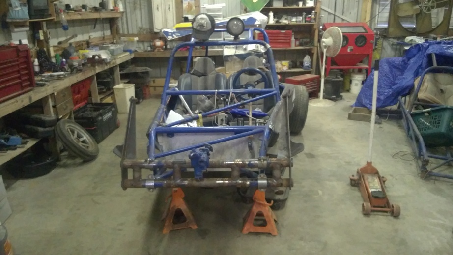

Front beam.
