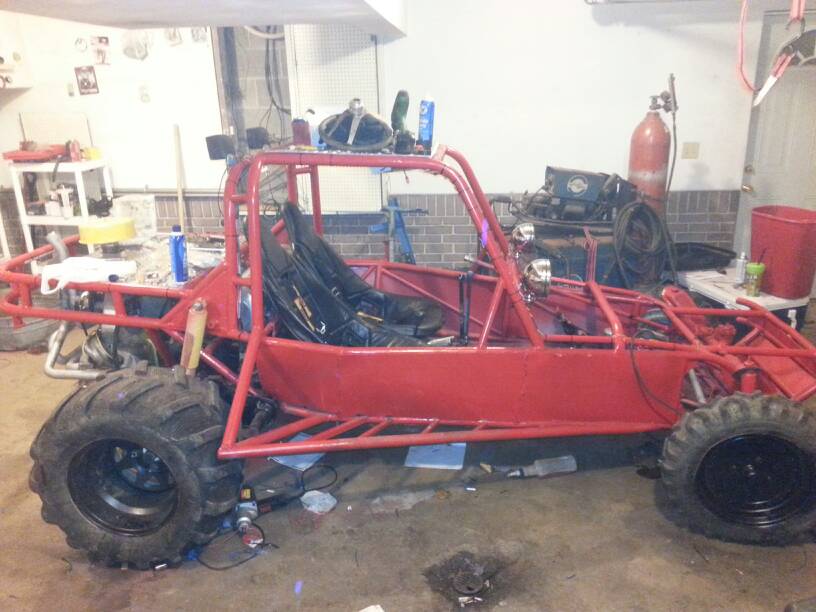

 Post subject: My hack job!!!
PostPosted: Thu Nov 21, 2013 5:22 pm
Posts: 231
Location: toronto ohio

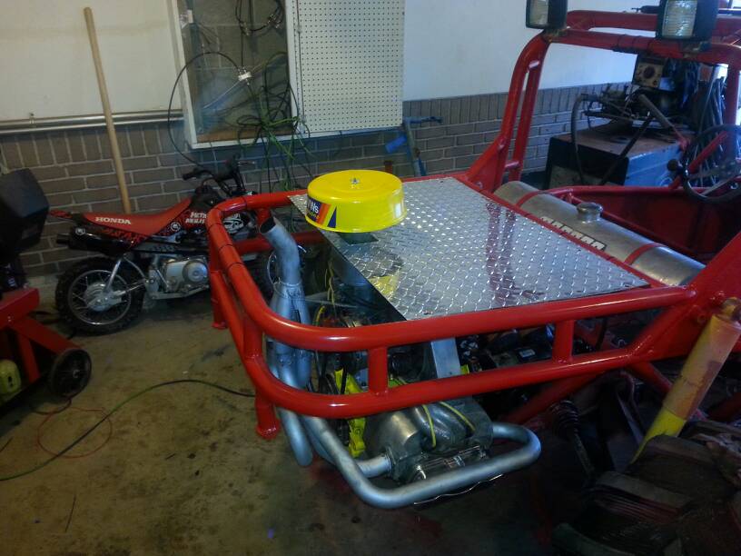

 Post subject: Re: My hack job!!!
PostPosted: Thu Nov 21, 2013 5:23 pm
Posts: 231

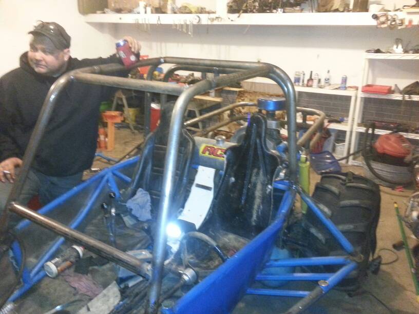

Let me know what you think!!

Looks good to me ya hack ! 8)
PostPosted: Thu Nov 21, 2013 5:39 pm
should have left it a convertible :lol:

Haha made little hopes around your head!!
PostPosted: Thu Nov 21, 2013 5:46 pm
Posts: 231
New seats, belts .3x3 . 3 inch raised spindles and a 6 rib and I'm done!!
I was thanking looks good for a hack :D :D

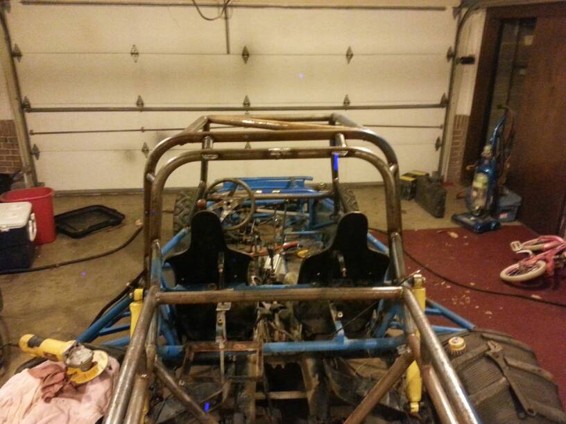

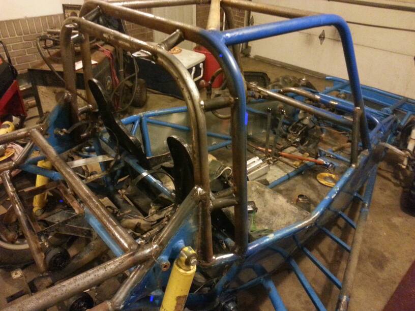

looks good . wheres the X brace .

Double roll bar what do I need it for lol?

Looks really cool... But I have to agree, I like the convertible option.. :lol: :lol:

good job, but I would have kept it Wild Cat Blue. :lol: :lol: :lol: Go Cats.
the "X" holds side to side when you barrel roll, would not go out with out one now IMO

X brace probably would have helped Bill a little.

Yes it would be nice to see an x brace and support for the rear cage as well as more support for the front hoop. But it only matters if things go bad. Looks good overall.
Good luck

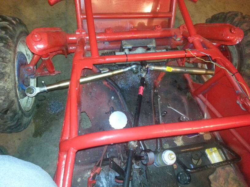

Those tractor link heims are going to wear out FAST. I've seen it tried multiple times. Keep them coated in grease, and they might last longer.

I bought the bigger ones that are all hardened..
