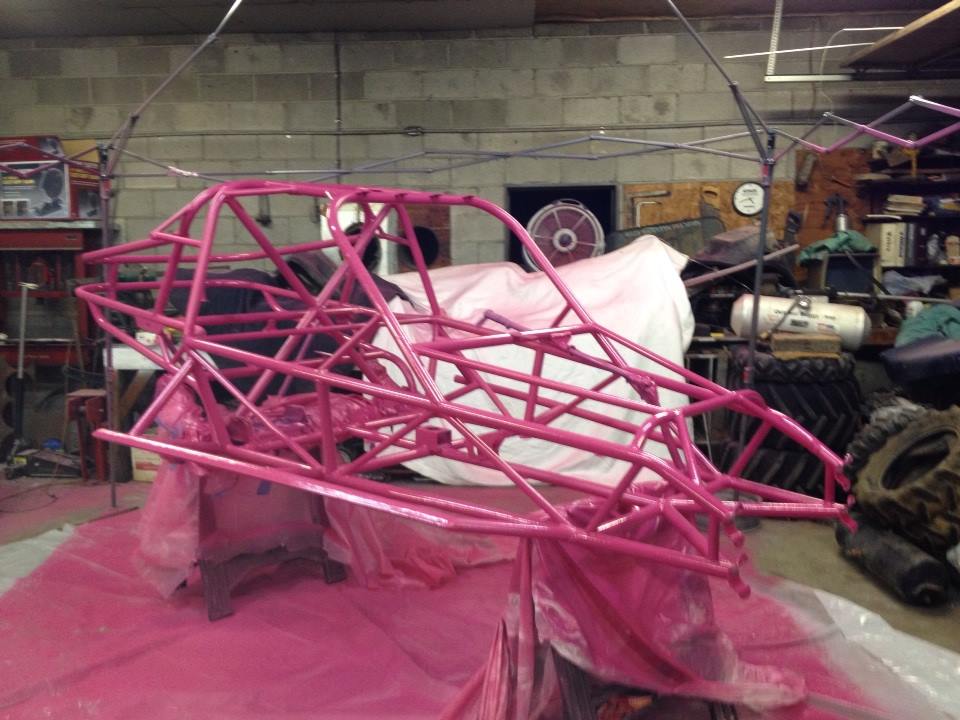

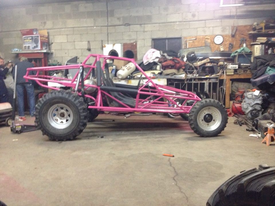

I know its been a while since ive posted anything but with this damn weather and life Getting in the way. I finally got to add Color!! Yup Its Pink!! My Aunt Was giving me a hard time about what color I should paint it and Well, Shes a Stage 4 Breast Cancer Warrior so You guessed it!! Its Pink!! BUt I do Have to say something!!! I will never spray another buggy with CaR PAINT again!!! Either it will be rolled and painted with An Enamel, Spray bombed, Or powder Coated!!!

PostPosted: Tue Feb 25, 2014 2:40 pm
That's cool I painted one of my buggys pink and yellow until it faded and couldn't tell what color it's was but a lot of people messed with me about it but pink is my favorite color. Ps I hope your aunt is doing good
PostPosted: Tue Feb 25, 2014 9:59 pm
Hey Jarhead why do you say you'll never use car paint again? ...and what is spray bombed?
Sent via TapaTalk
PostPosted: Fri Feb 28, 2014 11:50 am
Posts: 95
Location: Ashland Ky
Thank you Jeff Shes Hanging in there. Still gets out when she fells good enough and She always has a Smile. Shes at Peace but shes still fighting. THe buggy is Coming around just down to Details. As far as the Color I like the pink too but My Aunt Loves it, and thats all the Matters. Spray bomb is A Rattle Can Paint Job and Trying to Spray tubing with $100/gallon car paint sucks, especially when you dont know how to paint!!! Plus the Fact of knowing that buggy has a damn good chance of sliding off a hill on its side or top in the near future. LOL!!

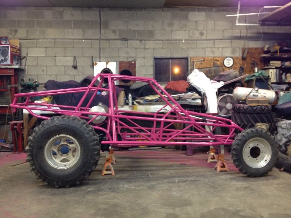

PostPosted: Fri Feb 28, 2014 12:15 pm
Looks great i love the color, im with on the painting with a gun it sucks. Trying to keep it wet to get a nice shine and the overspray...
PostPosted: Fri Feb 28, 2014 12:40 pm
LOL ok - lookin good tho!!!

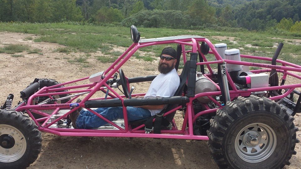

PostPosted: Wed Sep 03, 2014 3:23 am
Posts: 95
Well Guys I finally got it goin! Tooke it on the Shake down Ride! Just need somefine tuning on the suspension and some better seats!!
10666060_10203432762313244_718368115477226534_n.jpg [ 152.09 KiB | Viewed 11168 times ]
PostPosted: Wed Sep 03, 2014 7:38 am
Great job! Thanks for sharing the build!
