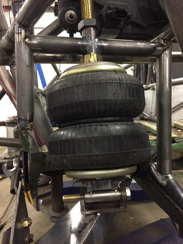

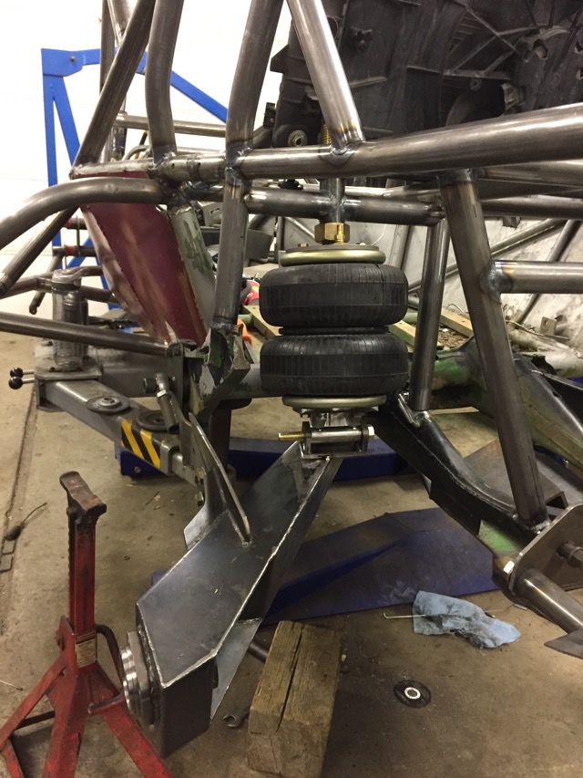

Well the cage is almost welded up - my old man has been working on the rear suspension, mounting his new 3x3's and torsion eliminators with his new airbags. We picked up 4 airbags, they are the 3800's from airbagit. It took him awhile to get them all mounted, they pivot at the bottom, angled with the trailing arm and are fully adjustable. The whole point of this is to be able to achieve any ride height he wants with any pressure he wants. He has around 20" of travel with the way it's set up (obviously limited to around 14-15" with the axle angles) but none the less pretty impressive. They have no binding or twisting at all thanks to the fancy mount. Tranny was also sand blasted and re painted while it was out!
Slow and steady! Next is flipping the buggy over to reach a few more welds and re do the floor with nice checker flooring, then on to paint and assembly 8)

Nice bag mounts. Buggy looks good. Keep posting.
