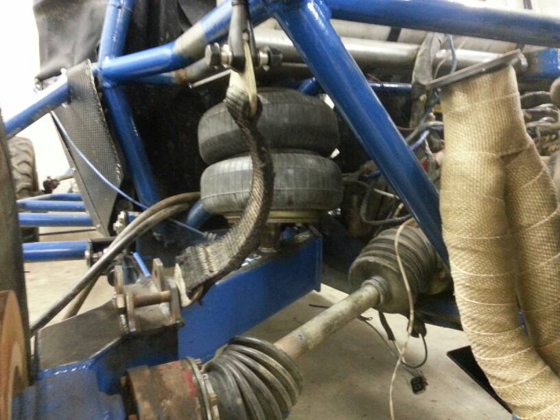

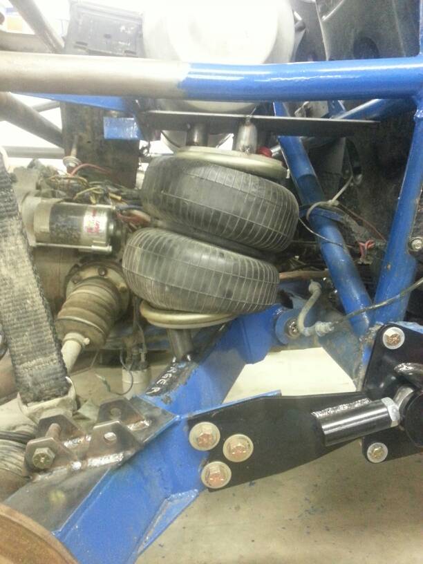

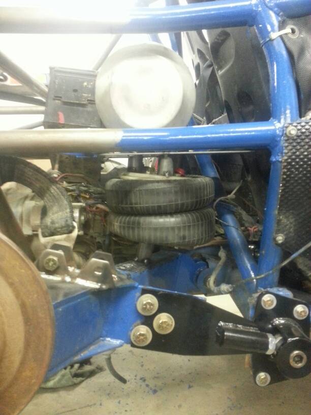

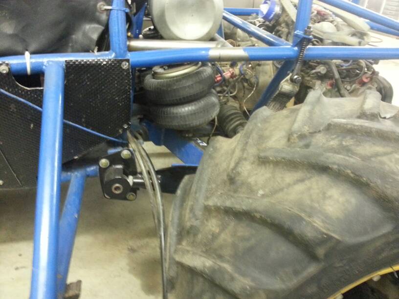

PostPosted: Sat Jan 04, 2014 6:17 pm
Posts: 67
I got the mounts tacked in should I do some adjusting to these?
PostPosted: Wed Jan 08, 2014 10:08 am
Posts: 67
Does anyone have any suggestions on the way I have them mounted? Is there any way to get the bag more flat at the bottom with the arm down?
PostPosted: Wed Jan 08, 2014 12:24 pm
Take a look at some of the other bag threads. You need a pivot on one of the bag mounts to all of for the travel
PostPosted: Fri Jan 17, 2014 11:36 pm
Posts: 67
I just decided to get the bag in there as good as possible without a pivot. I got 35psi in the bags and its sitting pretty good.

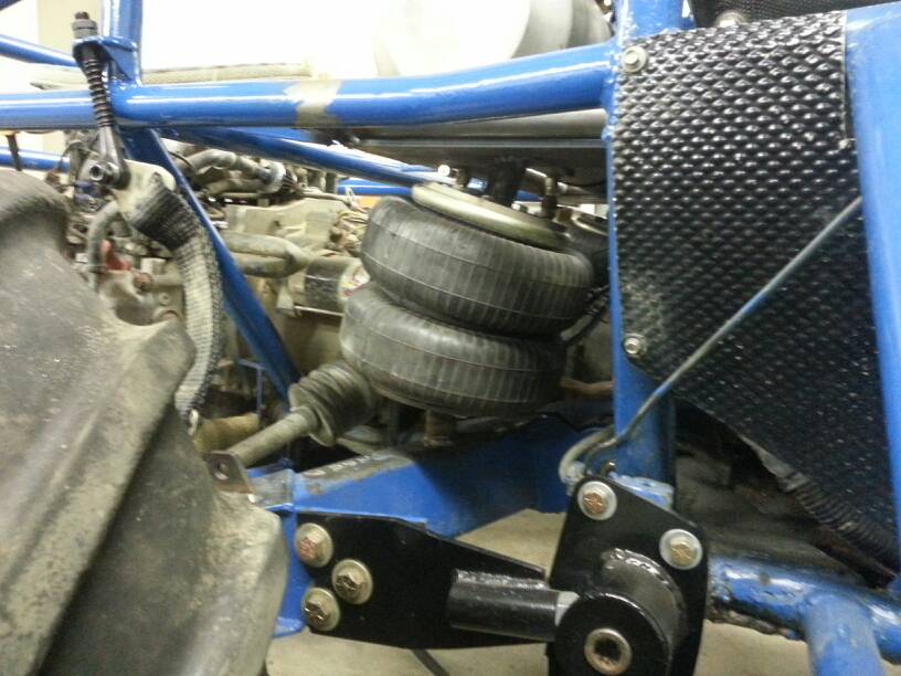

PostPosted: Fri Jan 17, 2014 11:38 pm
Posts: 67
PostPosted: Sat Jan 18, 2014 12:31 am
Looks good I think you will be very happy with your choice to go with bags
