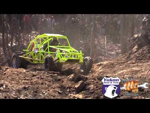

Mike
I would like to see how thedrive train set up in this buggy would work with a supercharged echo instead of the turbo suby

PostPosted: Tue Sep 01, 2015 12:23 pm
I cant remember.... did he have a mendola or the power glide and supra rearend? i know it was mid engine
PostPosted: Tue Sep 01, 2015 12:30 pm
Power glide and supra
