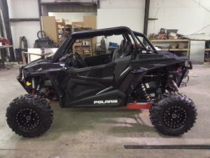

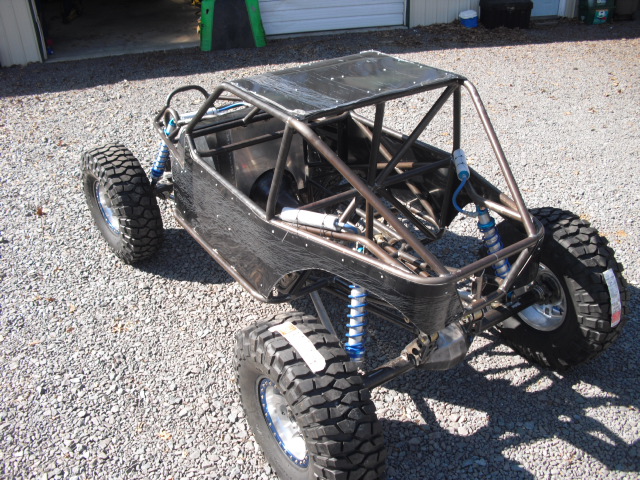

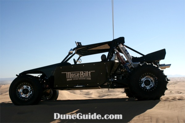

will this work. not as pretty but is it too tall. i know its a crawler but i like the forward cab and height. or a stretched rzr style or sand buggy.

Im really curious of how the mid engine handles. Does anyone have any suspension expertise. Im thinking the rear trail arms should mount as far forward as possible. Not for travel but better weight distribution and traction. Anyone?

I think it is a good idea, but you will have trouble fitting it all into a usable sized package (wheelbase), and the weight distribution will be off what you want for a woods buggy. My race buggy is just a little more balanced (front to rear) than an average woodsbuggy and wont climb worth a shit. I do like the idea and not using a bus trans in theory is great!!!

For climbing the ideal balance seems to be around 30% front & 70% rear & I've seen expensive nose heavy buggies struggle with easy climbs that a beat up rail with a 3-rib & a smoking 1641 could walk right up because it bit hard & hooked. I built a 78" rail from junk years ago that had weight racks so I could move 40-70 pounds around until I got a good bite without nearly going over backwards. That rail was 34%-66% on the scales but that short wheelbase needed more nose weight to be stable on long climbs.
My single seat will hit the scales once the engine is in & I'll put 60 pound dumbbell weights in the right spots to simulate a full gas tank & oil. I'll place the battery where weight's needed & run either steel or aluminum front wheels to set it up as close to 30% as I can get.
You probably have 120-ish pounds of weight you can shift to the rear & aluminum front wheels may get you close enough to ideal.
