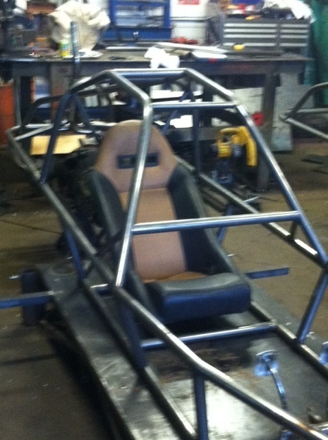

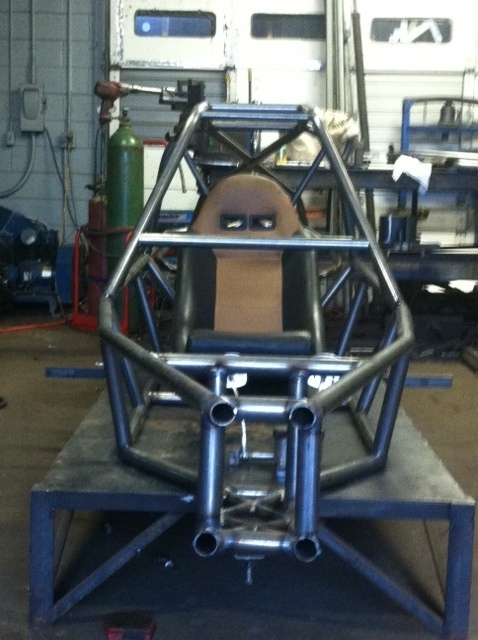

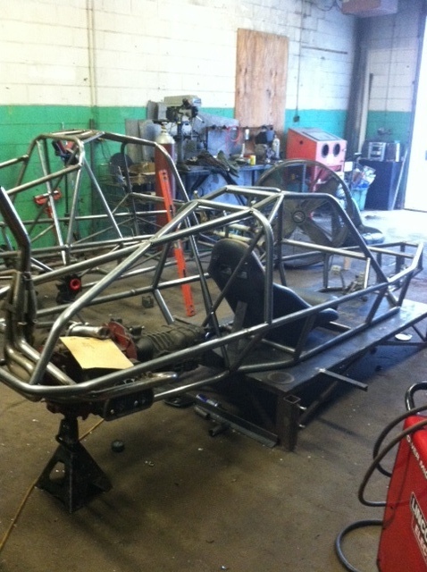

Incase your wondering this is a chassis im building for myself. It will be a front & rear A-Arm design with a VW engine.
PostPosted: Thu Sep 12, 2013 8:30 pm
Nice! That 1st pic looks like R2D2 sitting in it from Star Wars. a droid!lol

You can see how small this chassis is if you compare it to the typical height of the Predator chassis beside it in pic 3. The rear headbar is only 19" high and i still have 7" of clearance. It is also 13" narrower
PostPosted: Thu Sep 12, 2013 8:50 pm
Sick lookin frame
PostPosted: Thu Sep 12, 2013 9:56 pm
Ya out did yourself in two ways ! First the frame looks great ! And two we now know you can post pics and we want a full progress report !!

Great lookin chassis. The only thing I think needs attention is the width of the roof over your head. My 2 seater had a narrow roof and my head hit the ground in one of my rolls, thats why both my buggies cabs are well outside my shoulders. Just my thought though. Keep up the good work.

Nice SS frame. Are you planning on adding parallels to the "X" on the top rear? It would seem all the stress would be only at the center junction .
PostPosted: Sat Sep 14, 2013 11:45 pm
Yeah, the intersection, as long as that run is. I like to over all look of it, I would have done a few things differently. Definitely a build I'll be paying attention to. Nice work.
Yes, thats were the top mount of my coil-overs is going. The frame in these pictures has very little bracing installed.
