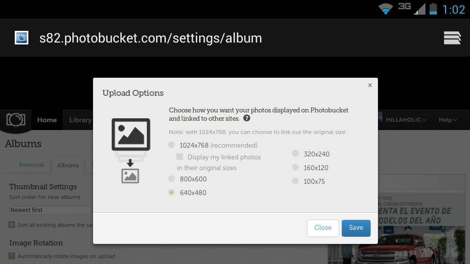

PostPosted: Sun Aug 11, 2013 12:54 pm
You can go to settings in photo bucket and set the size. Then any picture you upload will be the correct size.

PostPosted: Sun Aug 11, 2013 1:03 pm
