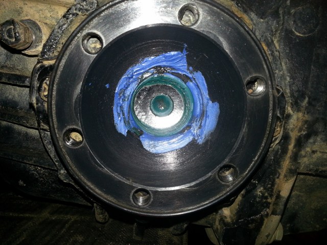

I took my motor and trans out. Looks like my axle been rubbing the trans flange pretty hard. I have stock arms with 930 cv's the axles are 16 1/4" . It doesn't seem to bind when the suspension is level but I will check again when I get the other tranny in. :roll: You can see it wore thru the rubber seal and into the flange.
i have 930 with 3x3 arms and mine did the same thing...on tranny side and on stub side. i ground off the axle end a little and it helped but they still rub a little
PostPosted: Tue Feb 11, 2014 9:03 pm
I just ground mine down also. It might be the way the 930 flange is made. But mine only rubbed on the driver side. That side is 1/8" wider than the passenger side. Which makes the passenger side shorter. It should have been the one to rub if any. :roll:
PostPosted: Wed Feb 12, 2014 12:13 pm
Same story here, mines rubbing. Hoping to fix it while I got everything apart.
