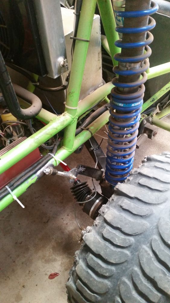

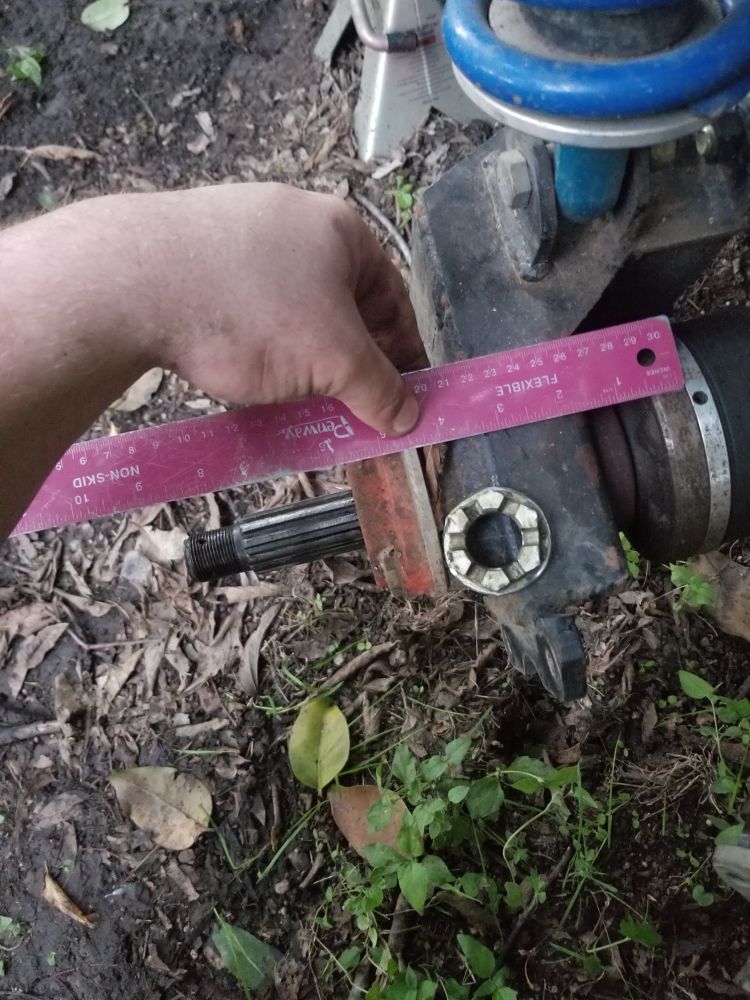

I am currently running these. My rig is about 70 hp with 3 rib . I do medium trails and had 0 prroblems with the spacers they are kind nice to be able to put the cv on with 0 grease.
Dont have any pics of just them but here is what i have. I took the zerks off the lower cv side and put in the plugs, i dont want to break the zerks off
PostPosted: Wed Oct 31, 2018 11:50 am
Posts: 143
Here are the pics i found
