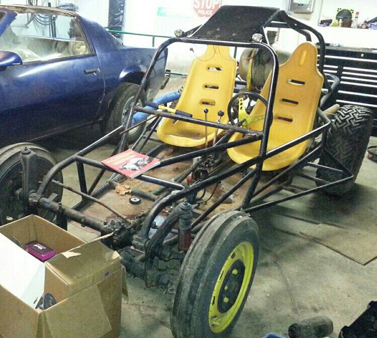

Just Bought a 1963 Volkswagen two seat rail buggy, has 1200 VW Engine on it. Has CNC Single lever brake, Two 4-point harnesses. The bad, Engine seized, rear wheel cylinders leaking bad, Tires are brand new (but at least 8 years old), starter doesn't turn. needs battery, air cleaner, and possibly many other things. Front shock tower on driver's side is rotting out and all boots are dry rotted. but the rest of the buggy is solid. no title. Was it worth $800
PostPosted: Sat Nov 02, 2013 9:35 pm
Seems like a fair price for a complete buggy. Post some pics to get a better idea what your dealing with.

i will take some pics and post tomorrow. Any ideas on how to repair the shock tower? it's a ball joint front end

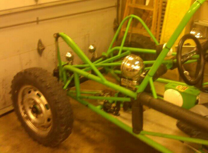

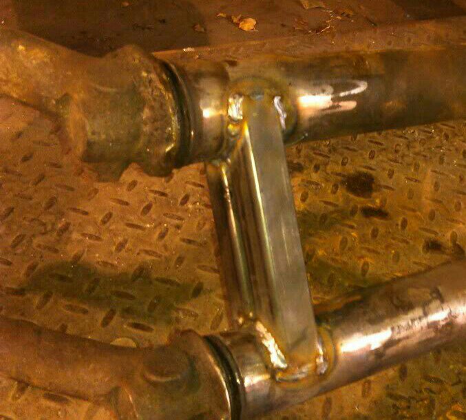

Not sure of your Fab skills or equipment but I cut mine out rebraced the beam and made new shock towers

Your front end looks a little different than mine. I was going to add supports to it, but it is thin metal and curved. Will probably end up cutting it off and making my own.

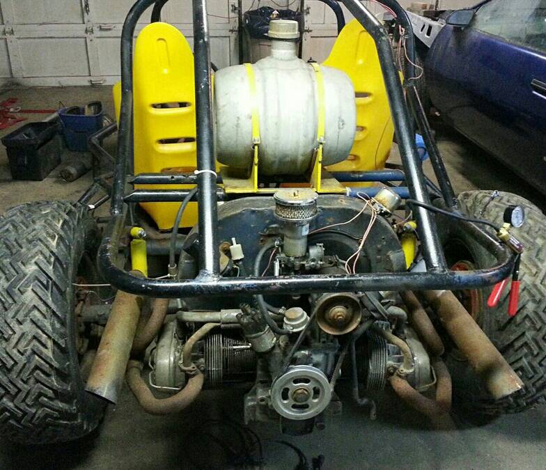

The tins are missing off the cylinders. If you don't have them you need to find them cause it won't last long without.
I have the upper tins, had to trim them today to make them fit. got a steering brake issue, changed wheel cylinders,then bled out my brakes. have really good pressure on brake pedal, but when i push the lever forward, the pressure leaks off. Was reading online that you have to ride and re-bleed them for it to be correct. put on plastic pushrod tubes (using these to test engine). If she doesn't explode, i'll change all the base and head gaskets, install new pushrod tubes, then start on accessories. If she does blow, might be parting it out.
