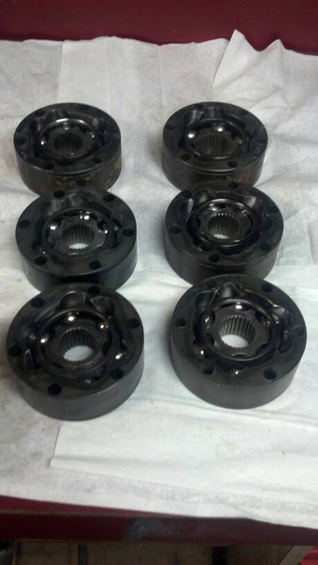

After breaking two 930 joints in one day I decided to pull all, polish and repack with grease. I hate this shit but it's better than being drunk in the woods changing one on a hill.

I haven't broken a CV in a long time. I have straps and sway a way bars. I think they broke because my frame bent loosening the straps up. I can't believe the straps stretched more, they've been set for two years. I jacked my buggy up to check for bent stub axle and my axle pulled out of the CV. Something stretched or bent.

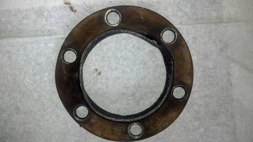

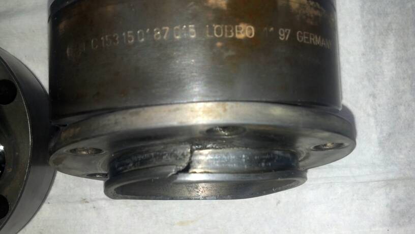

They are race prepped, clocked and pretty loose. If I pick up a dry one and tip it it will fall apart. The boot flange on two of them are bent and one is cracked. You can actually see where the balls hit the boot flange.
That is evidence that the CV is being pushed beyond its limits of angle and more than likely the source of your failure. There a several simple solutions one being limit straps or shorter limit straps or shim the nose of the transmission back 1/2" to reduce the angle on the cv.

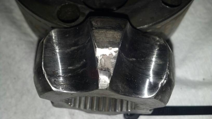

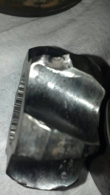

Image the shiny spots are chips
 Post subject: Re: cv fun!!!
PostPosted: Thu Aug 15, 2013 3:02 am
Are they Lobro? The color makes them look like they're EMPI. Did you race prep them yet? If not I would race prep them and smooth the chips out. I have 2 spares that have chunks off the inner star, they'll be better than nothing.
PostPosted: Thu Aug 15, 2013 3:09 am
These are lobro centers. I think the broken cage got in there and chewed shit up. I took 60 grit flap wheel and took the big chunks off then polished everything with 120 grit.
