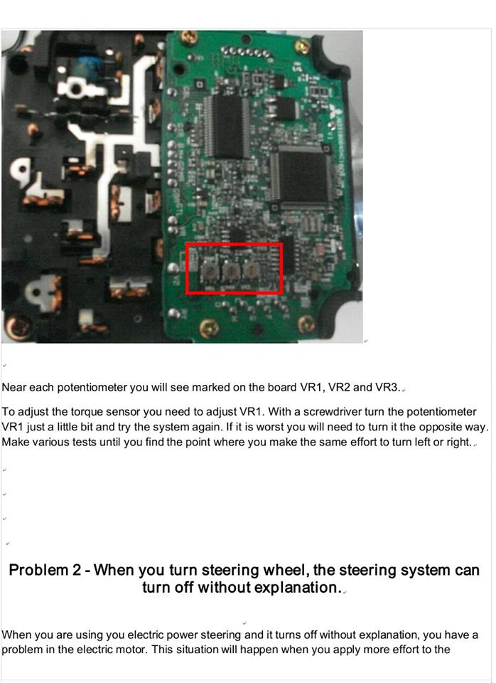

if im reading all this correctly, you are asking this question because your power steering quits at times? also did you buy and install the adjuster kit off of ebay that your "supposed" to use with it?

Yes. I bought the kit. Even if the EPS didn't shut down I think I need to upgrade the generator. Under certain circumstances at night I am way under on amperage. I don't want to damage my deep cycle battery. Winch (at 2000lb pull) 132 amps, LED light bar 2 amp, 4 lights 3 amps, EPS 20-30? amps, tail lights 2 amps. No doubt generator is taxed out. Problem waiting to happen?? More so than not.

oh generator! yeh toss that!im thinking mine is a 95 amp?vw alternator, haven't hooked up my powersteering yet cause im waiting on the part from europe :lol: but anyway read the bottom of this picture? and you said you blew a fuse once, maybe theres a problem with the motor? I copied this off facebook but it didn't have the whole description in the picture. sure would be nice to read the rest of that part :roll: didnt the ebay part come with these instructions

Yes. It came with instructions. I also didn't do the on/off switch like he said. I have it wired to the ignition instead being seperate. It probably needs the engine running before power going to the EPS.
