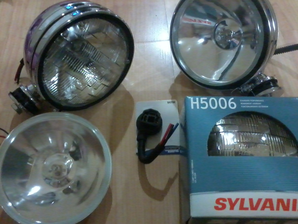

Sorry if this is a double posting but I was looking at affordable hi-low headlights when I came across a thread for modifying HF's offroad lights to DOT lights. You will need the following:
Off Road Light (item 95811) $11 ea
H5006 light housing (o'reily was $5 cheaper than Autozone) $9.95 ea
Dorman light harness #84790 $15 (for 2 lights)
The H5006 fits perfectly in the chrome housing and it looks classy on the rail. Tomorrow I will buy another set for my wife's buggy. I will post some pics in the am.

I'll let the pics do the talking
File comment: Wire harness from oreily
File comment: Left is converted, right is stock
