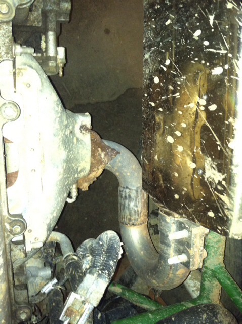

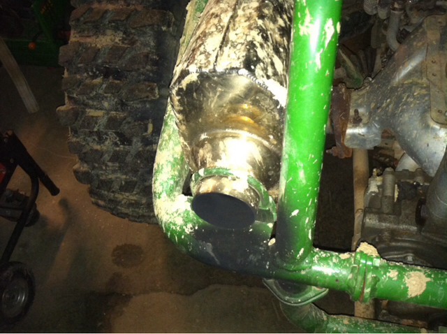

Author:  Jeremy1 [ Sat Nov 09, 2013 11:33 pm ]
Post subject:  Re: About to change to ECOTECH
Took a little to get this to work hooker muffler and couple u bends from summit racing
