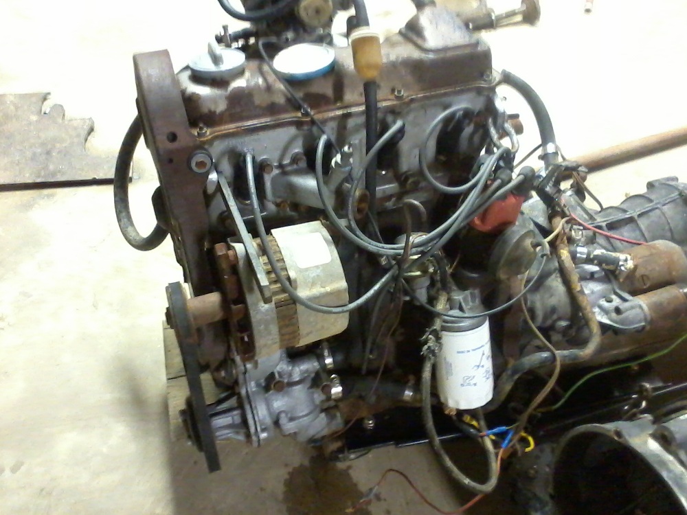

PostPosted: Mon Oct 14, 2013 9:56 pm
Posts: 118
Location: Birmingham, AL
Rabbit engine resting in the garage next to his future mate, the 3 rib transmission. This weekend I plan to remove all the different parts off the block, paint it either black or silver and paint the head cover and front cover yellow to match the 4 seater.
