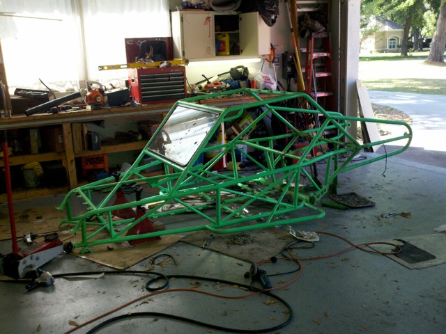

I will never go water cooled again with a heavy water cooled motor unless at least a foot of baby chains was added. It makes ALL the difference ! gearing, center of gravity, and some added hiegth.But narrow is very important too because too wide will make the buggy pull lt n rt depending on which side is biting, and there is not enough side to side room on most hill climbs. Sometimes you will be so wide that you HAVE to hit an obstical coming at you.
If you build the chassis yourself you can adjust the center of gravity to account for a heavier engine in the rear. The cars I owned previous to my limo were cab forward designs which shifted the center of gravity forward. So the heavy engine thing can be accounted for

My next contraption has a 4 cyl. Honda V tec automatic sitting exactly where a vw ac goes but sideways. then some short chains that connect to the existing inner c/v joints.Gear reduction with an automatic.nice!!
Sorry passat have to totally disagree with you. I think I finally have the gearing and weight distribution figured out. You don't need baby chains or turning the motor sideways to get it to work. Just proper weight positioning, the right gear for the hp, some longer trailing arms, the right driver and it works. And I know a couple 2 seat na ecotec buggies that do awesome. I honestly believe my buggy will compete with some of the baddest ac buggies out there now. With the right driver
