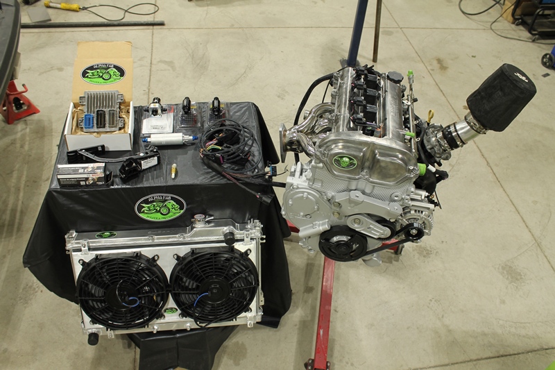

We support not only the L61 [2.2], but the LE5 [2.4] and now the direct injection 2.4's - the LAF & LEA.
We allow the option to run cable to electronic Throttle Body. We prefer and push the electronic stuff. Our TORC, SCORE, and BAJA teams all run them without issues.
We offer both turbo and supercharger options for all our kits. Along with custom forged bottom ends, etc.
