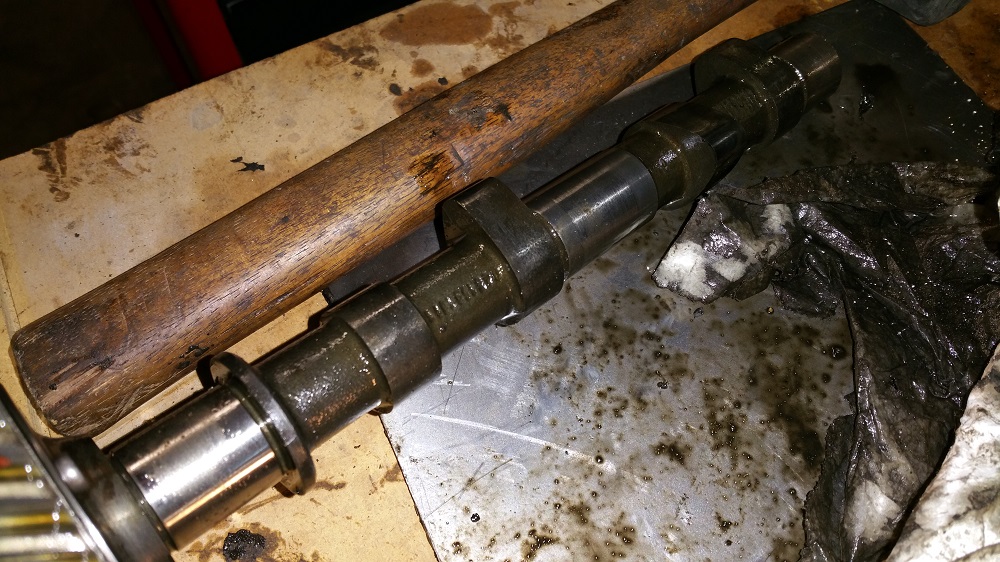

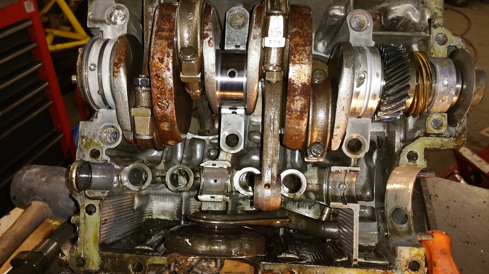

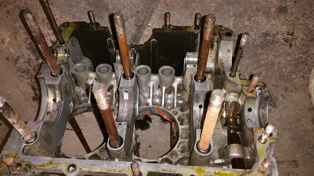

Well guys i finally got around and decided to see what was happening on the inside of the vw. The pinto is just too long for the back of my cage about 3" too short. Pistons measured about 91.5mm so I guess its an 1835. Stock mexican vw heads.
I checked the endplay before i tore it down and was .010. I expected worse but it still didnt look too pretty inside.

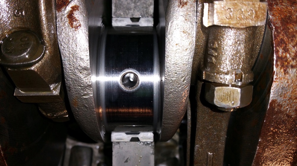

l
