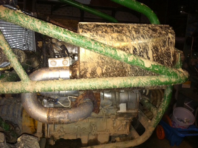

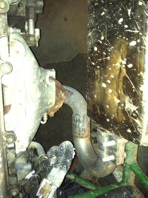

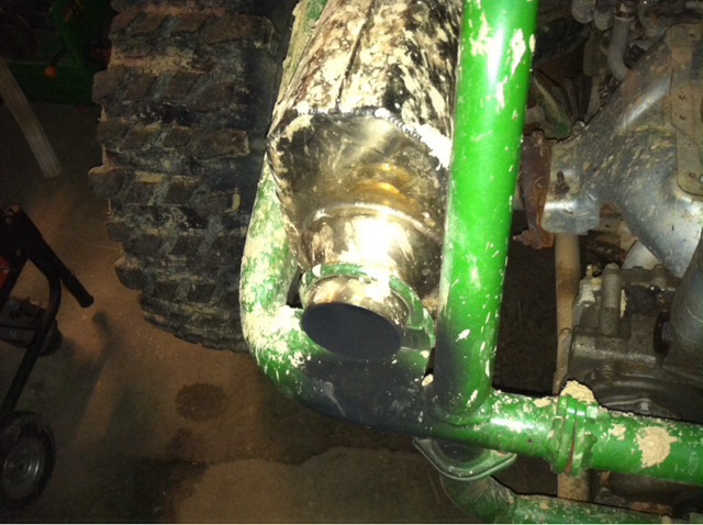

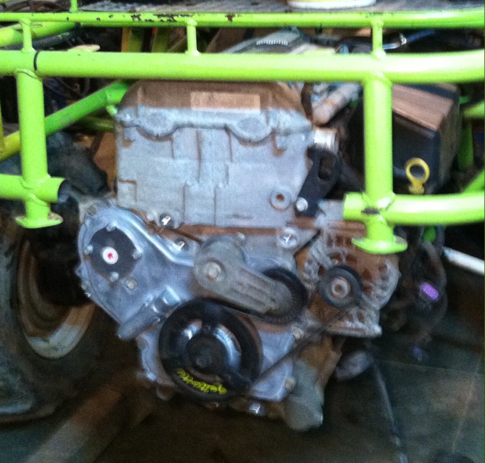

Took a little to get this to work hooker muffler and couple u bends from summit racing
