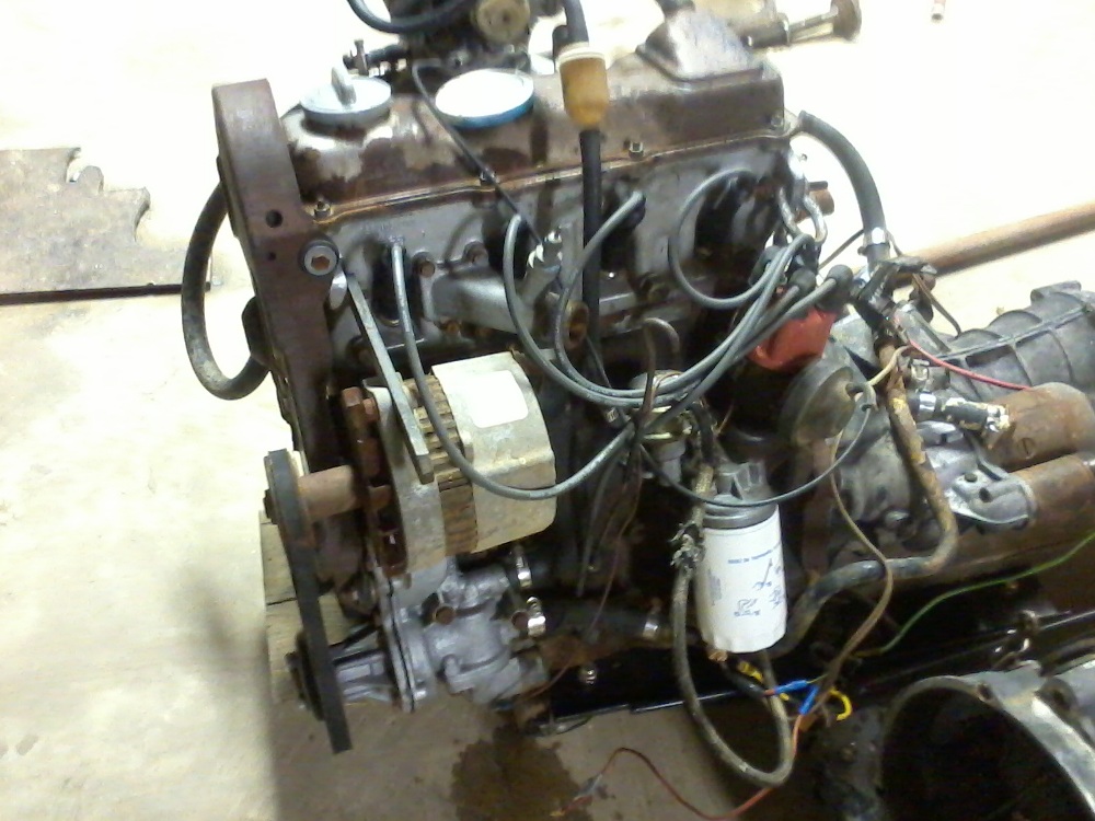

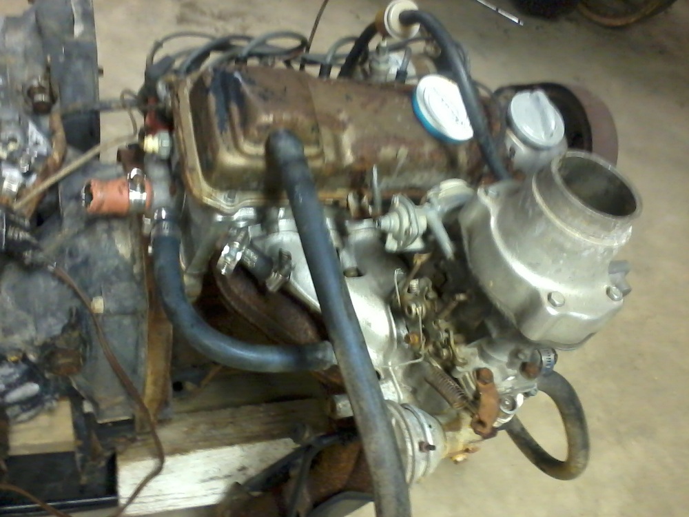

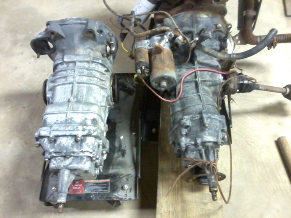

Rabbit engine resting in the garage next to his future mate, the 3 rib transmission. This weekend I plan to remove all the different parts off the block, paint it either black or silver and paint the head cover and front cover yellow to match the 4 seater.
If anyone has a set of headers or any performance parts for the motor please let me know, I will be interested in them.
