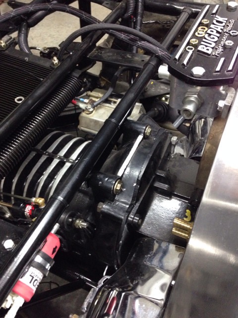

Ok, having a concern. I'm bolting a new engine into a fresh 6 rib that I just got back from chuck jones. It goes together an can get top bolts tight but has about 1/8 gap at the bottom.

I had chuck cut the input shaft off to what it's suppose to be. However I still like it could still be to long. Bolts get tight before case seats against the tranny. Don't like it at all.... Anyone know how long it's suppose to be from the splines to the end?

I talked to Tim at southern buggys. Earlier an he told me I had the right throw out bearing. Running a Kennedy stage 3. I snugged the bottom bolts an with 2 plugs out you can't turn the engine over. It's binding against something. I loosened it enough that it started to free up. Took engine back off to see if I could see any signs of rubbing. No luck... Guess ill sleep on it an try again tomorrow.

Some of the aftermarket gland nuts have a shallow bore to them where the pilot bearing is. This may cause the transaxle input shaft to bottom out in the gland nut. Worth checking into if you have an aftermarket gland nut. You might have to take another 1/8 inch off of the input shaft.

Guess pictures are not working with the app. Anyway thanks for all the replies. Here is what I've found, I do have a aftermarket scat chromoly gland nut. Looks like the input shaft is hitting pilot bearing on the taper going up to the splines. I've measured and have plenty of room for the input shaft it's not hitting crank.. Grind the taper of the splines back??? To accommodate the aftermarket pilot bearing?

What I meant to say was some of the aftermarket crankshafts have a shallow bore on the end causing the input shaft to bottom out in the crank.
Some of the aftermarket gland nuts also have the pilot bearing installed at a different depth than the stock gland nut causing the input shaft to bottom out on the pilot bearing. Sounds like this may be your issue.

I would not grind on the input shaft splines. I would switch it out to a 3 rib input shaft before i would grind on it. I think the 3 rib shafts have a shorter splined section than the 6 rib shafts if I remember correctly.

At chucks jones, he's cutting splines back a little to allow for bearing. I think this will fix it

Cutting the splines back worked! I have a scat gland nut in it now, the pilot bearing is at the very end of the gland but on the hex end. That being said a stock vw glam but is recessed towards the crank 3/16 which allows the input shaft plenty of room. Chuck said this is only 2nd time he's seen this. Just glad to be going in the right direction. Hope to throw some fuel an oil In her by end day Tuesday! Thanks guys for the input.
