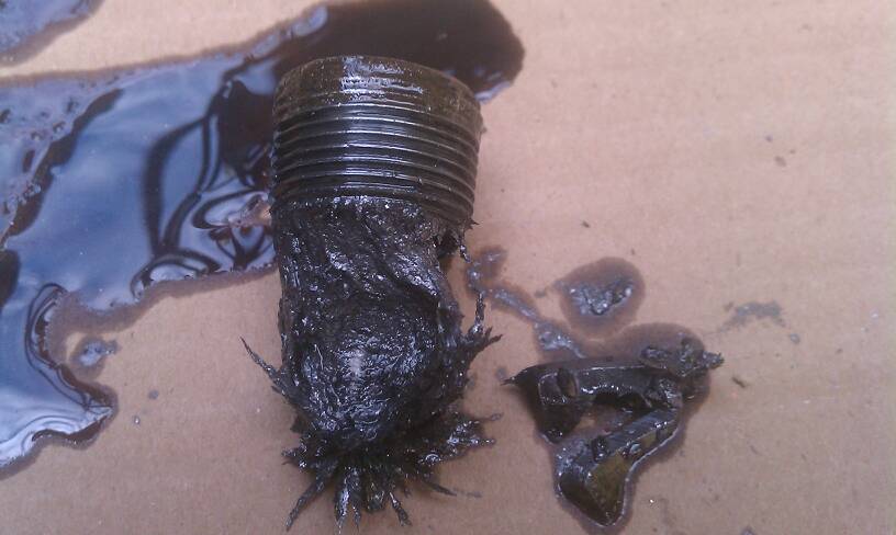

PostPosted: Fri Jul 12, 2013 12:26 am
That's what happened when I blew my r&p.
