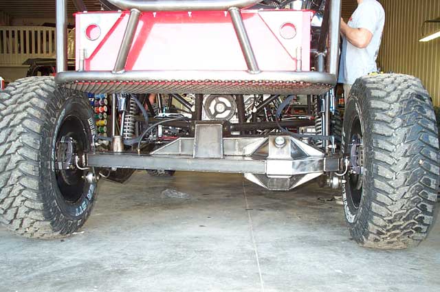

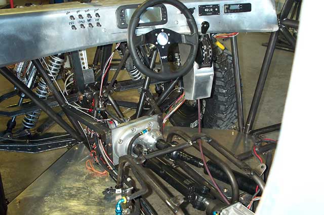

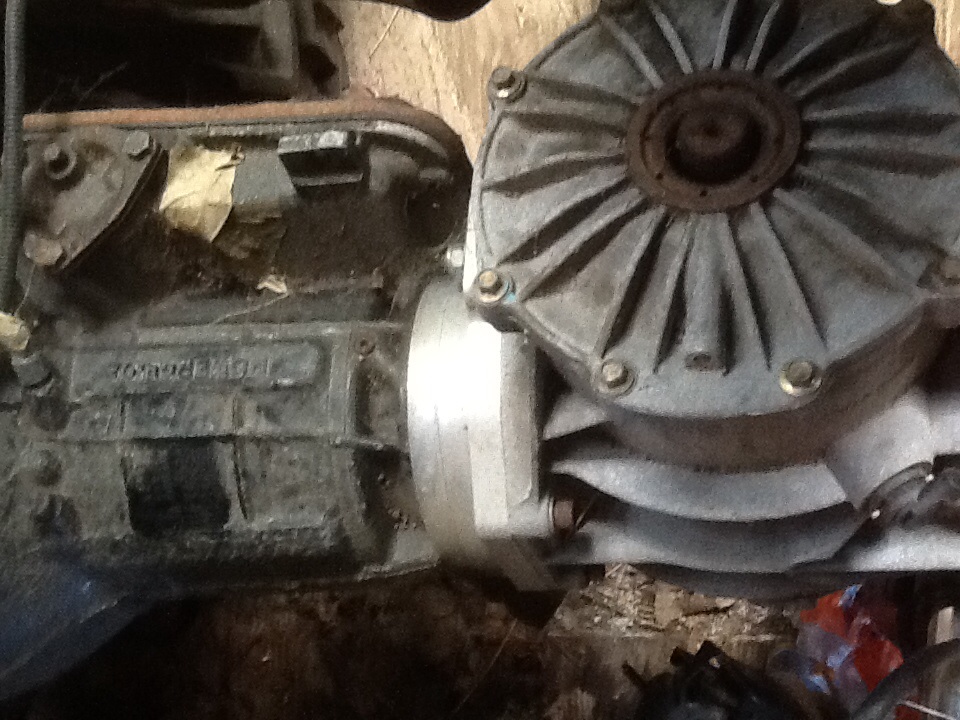

If you go the Colorado sand cars route you just need a v-drive and a couple custom drive shafts and that staggered rear end. Then pick a drivetrain and go...

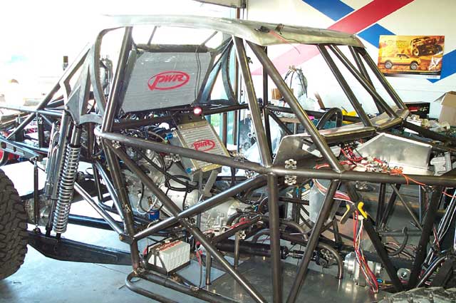

One of these. Powerglide to a C5 diff. Chad :mrgreen:
