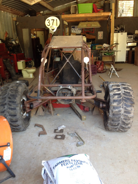

I redrilled my rotors and I think , they will work great
