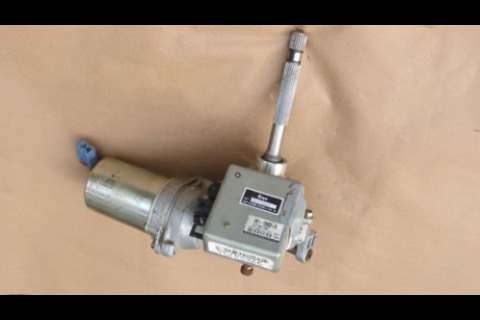

PostPosted: Mon Dec 09, 2013 7:47 pm
Here is a pic of a Saturn Vue EPS
