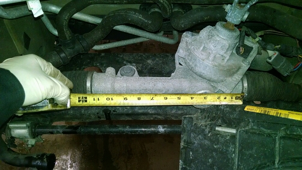

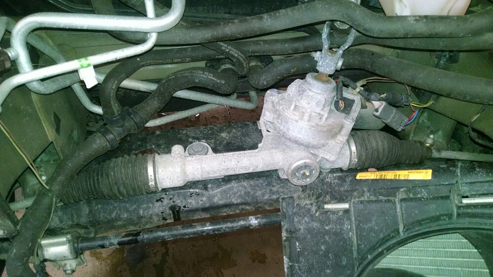

Don't know how feasible it is to make one of these work but I saw this short ass r&p and thought buggy right away. It's in a smart car. Thought I would post it as people are always looking for alternatives.

to keep down on bump steer, you want your tie rod ends to be almost touching in the middle. end load racks are not the best set up for beam front ends.
