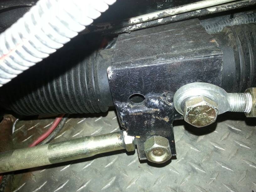

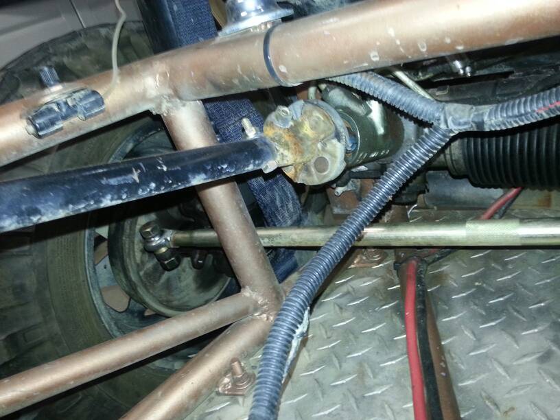

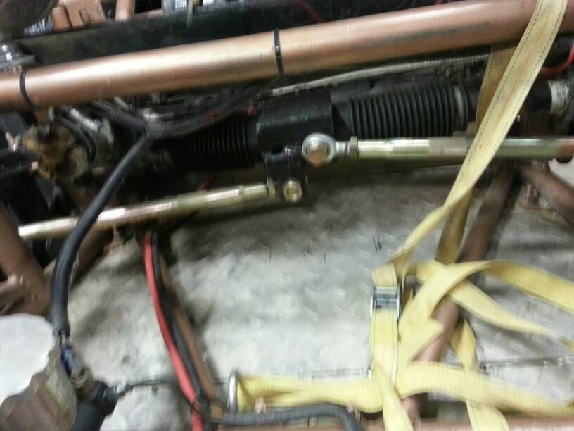

Imaged
Not the best picture. I cut turned and welded mine so I can mount on the front of my beam.

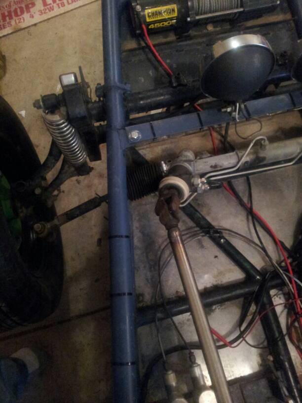

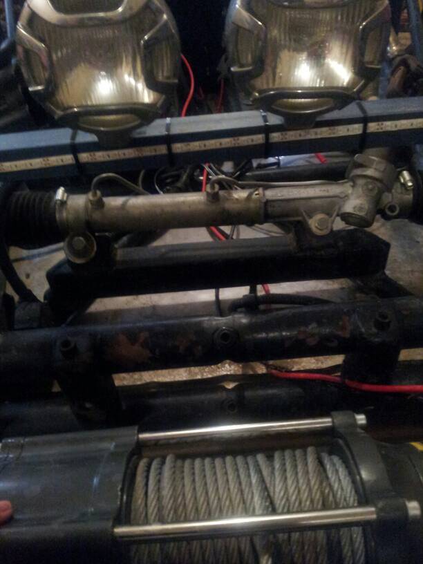

PostPosted: Wed Jun 18, 2014 9:05 pm
[attachment=-1]uploadfromtaptalk1403139163323.jpg[/attachment][attachment=-1]uploadfromtaptalk1403139186986.jpg[/attachment][attachment=-1]uploadfromtaptalk1403139211276.jpg[/attachment]
Been running mine for 2 years no problems. Very little to no bump steer, just put 400 road miles on it last weekend. I believe mine was off a 04. Im running stock link pin. I cut the rods back a few inches then drilled out some round stock the drill size for 5/8-18 was the size of the rod welded it on and I used heim joints.

PostPosted: Thu Jun 19, 2014 10:22 pm
Mines a 1995 Grand Am. Made a "u" shape 3/16" thick channel. Bolted to front of rack then bolted tie rods to the other side. That way rack is bolted against the torsion. Works pretty good.

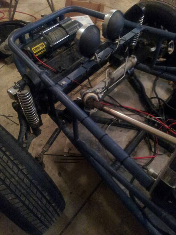

PostPosted: Sat Jun 21, 2014 6:50 pm
[attachment=-1]uploadfromtaptalk1403390961842.jpg[/attachment][attachment=-1]uploadfromtaptalk1403390977674.jpg[/attachment][attachment=-1]uploadfromtaptalk1403390996725.jpg[/attachment]
This is my 95 Grand Am R&P setup.
PostPosted: Sun Jun 22, 2014 12:08 pm
why is the left heim bolted lower on the rack?
PostPosted: Sun Jun 22, 2014 12:22 pm
I think I needed the clearance for the arm to clear the frame.I really cant remember.
PostPosted: Sun Jun 22, 2014 2:54 pm
I remember now. I didnt use a steering universal joint out of the Rack. So I needed more
clearance under the steering coupler. If I used a u joint I could have twisted the rack up and it would have cleared the tie rod.

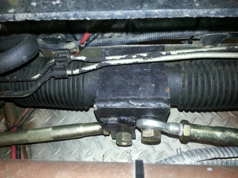

PostPosted: Sun Jun 22, 2014 2:57 pm
Under full suspension compression the tie rod would barely hit the steering coupler.[attachment=-1]uploadfromtaptalk1403463464348.jpg[/attachment]
