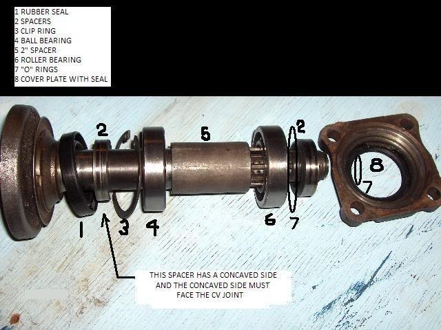

I just bought a ac industries rear disk kit for my rail we tryed every combo of spacers and they either clear the caliper brackets and stub binds up on something or change spacers around and rotor binds up on caliper bracket it's a cast bracket can someone post pics of the stub bearing /spacer placement for the disk

PostPosted: Sun Dec 01, 2013 5:55 pm

Son of a bitch it's gotta be a screwed up caliper bracket thanks for the pic man that helps

Ok I gotta be missing something here again my outter bearings fit perfect but the outter spacer is loose in the bearing plus to I don't think there long enough cause even with caliper bracket off I can't barely get any foot lbs on the axle nut and the rotor is binding
